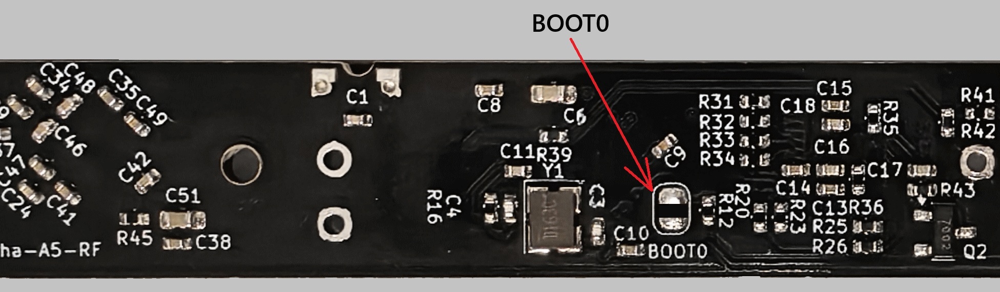

1.0 Use your soldering iron and solder to make a solder bridge (a small solder connection) at BOOT0 — see the picture below for reference:

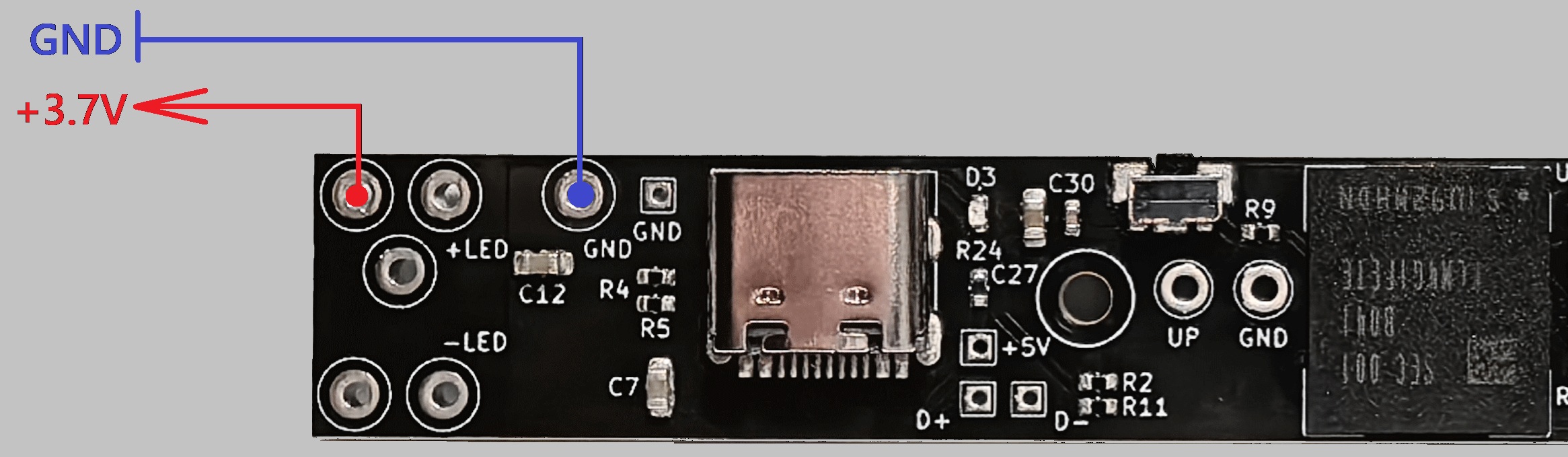

1.2 The controller power connection diagram is shown below.
1.3 Connect the power clips of the power supply unit to the A5‑RF controller, then press the Power On button on the power supply unit. Use a laboratory power supply with a voltage of +3,7 V and a current limit of 100 mA.

1.6 Using a soldering iron, remove the solder bridge (small solder joint) on BOOT0 - see the picture below for reference:

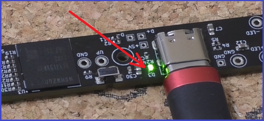

1.8 Make sure the Green LED (D3) indicator is working properly. It should light when the USB is connected.
